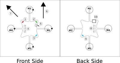

[[File:505.png|400px]] | |||
'''1'''.Red LED - Shows system alive and charge status | |||
'''2'''.Green LED - Shows radio communication and charging status. | |||
'''3'''.Blue LED - Shows power on status | |||
'''4'''.Expansion - Can be used to expand functionality by adding hardware | |||
'''5'''.Power push-button - Push button to switch the Crazyflie on/off (Note that this is a push button, not a sliding button) | |||
'''6'''.Front direction when flying in normal configuration | |||
'''7'''.Front direction when flying in X configuration, blue LED is at the tail. | |||
'''8'''.Expansion - Can be used to expand functionality by adding hardware | |||
'''9'''.Blue LED - Shows power on status | |||
'''10'''.uUSB charging - Used to charge the battery |

1.Red LED - Shows system alive and charge status 2.Green LED - Shows radio communication and charging status. 3.Blue LED - Shows power on status 4.Expansion - Can be used to expand functionality by adding hardware 5.Power push-button - Push button to switch the Crazyflie on/off (Note that this is a push button, not a sliding button) 6.Front direction when flying in normal configuration 7.Front direction when flying in X configuration, blue LED is at the tail. 8.Expansion - Can be used to expand functionality by adding hardware 9.Blue LED - Shows power on status 10.uUSB charging - Used to charge the battery
