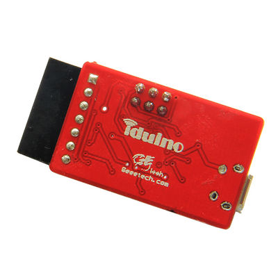

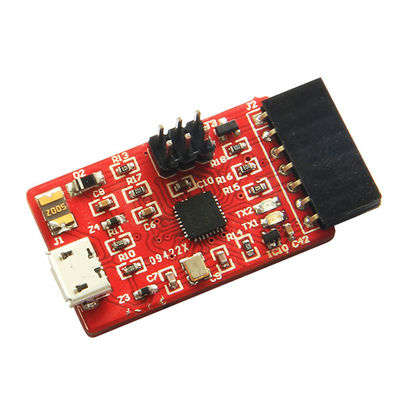

About DUE Mini USB/Serial Adapter
The DUE Mini USB/Serial Adapter is designed based on the ATmega16U2 circuit on Arduino DUE. With the bended female header, users could plug in the header to
Iduino DUE Mini board.
