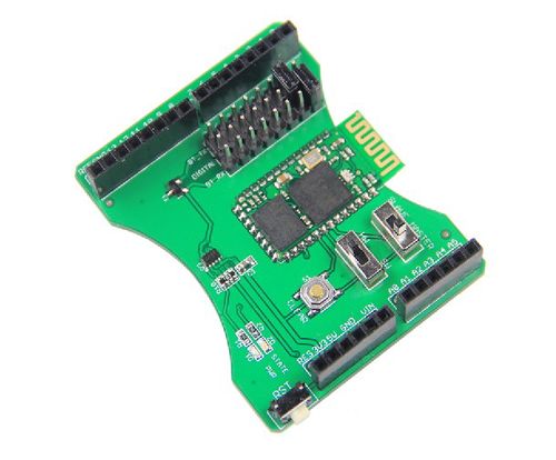

The Bluetooth Shield integrates a Serial Bluetooth module. It can be easily used with Arduino for transparent wireless serial connection setup. You can choose two pins from Arduino D0 to D7 as Software Serial Ports to communicate with Bluetooth Shield (D0 and D1 is Hardware Serial Port).

S1:Function button, This button is multi-function button include the function memory clearing (short press) which means delete the address of the bluetooth module connected last time and the function restoring the default configuration.
S2: The switch S2 is for hardware/software selection for master or slave mode. When the switch S2 is toggled to "HW" side indicate that you can set the module to either master or slave mode by switch S3. When the switch S2 is toggled to "SW" side means the master/slave mode is only decided by AT command "AT+role<0/1>"
S3: The switch S3 is for master/slave selection only if the S2 is toggled to "HW" side.
Selectable UART connection
Users can use the jumpers to connect the BT_TX and BT_RX pins(5V) of Bluetooth shield to any Arduino.
Users must be aware that which Digital pin of Arduino connects to BT_TX needs to act as Arduino RX pin(Hardware/Software), and which connects to BT_RX needs to act as Arduino TX pin(Hardware/Software).
