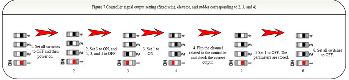

#Set all switches to OFF. | #Set all switches to OFF. | ||
[[File:XM image7.png| | [[File:XM image7.png|700px]] | ||
; Controller signal output setting (fixed wing, elevator, and rudder corresponding to 2, 3, and 4) | ; Controller signal output setting (fixed wing, elevator, and rudder corresponding to 2, 3, and 4) | ||

- Controller signal output setting (fixed wing, elevator, and rudder corresponding to 2, 3, and 4)
- Set all switches to OFF and then power on.
- Set 3 to ON, and 1, 3, and 4 to OFF.
- Set 1 to ON.
- Flip the channel related to the controller and check the correct output.
- Set 1 to OFF. The parameters are stored.
- Set all switches to OFF.
