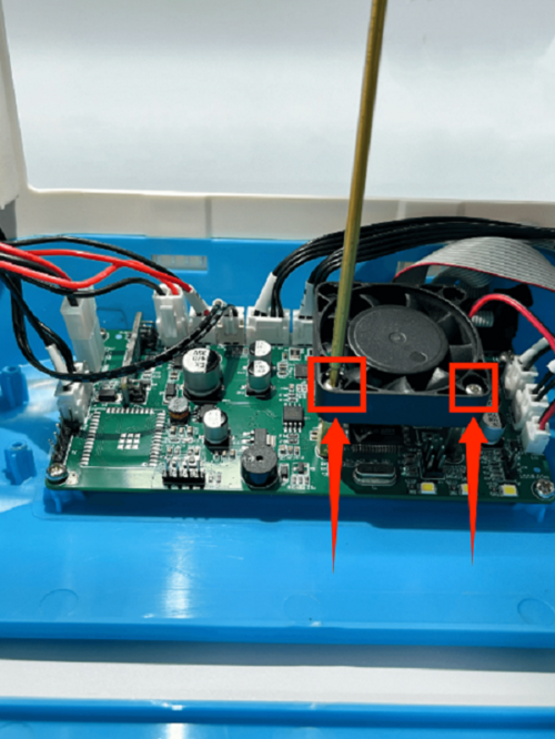

=== '''How to Replace the Control Board'''=== | === '''How to Replace the Control Board'''=== | ||
1. Place the printer upside down | |||
[[File:RM_1.png|500px]] | |||
2. Remove the fan screws on the motherboard and remove the fan | |||

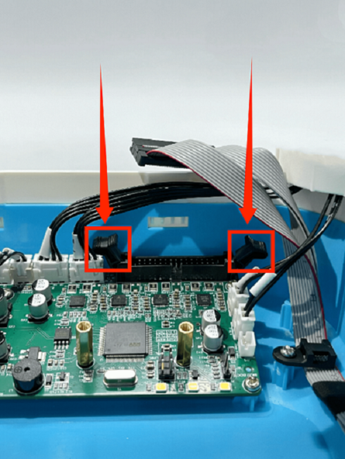

3. First remove the connection wire between the motherboard and the print head adapter board, then remove all the connection wires on the motherboard | |||

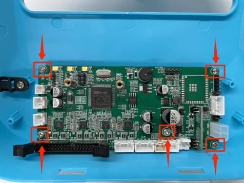

4. Use a screwdriver to remove the 5 fixing screws on the motherboard, unplug the screen button, and remove the old motherboard | |||
