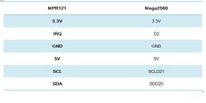

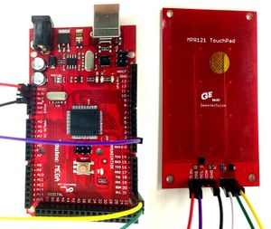

MPR121 touch sensor module can be connected and communicate with PCB whose operating voltage can be both 3.3v and 5v. As mentioned above, the connection method varies when connecting to different PCBs with different operating voltage. Here we set it as an example to connect it with Mega 2560.
Get Started
1)Connect MPR121 to Mega2560 with a USB cable, if the LED lights, the connection is ok, as in the following picture.
2)Connect MPR121 touch sensor module with Mega 2560 in light of 3-1
