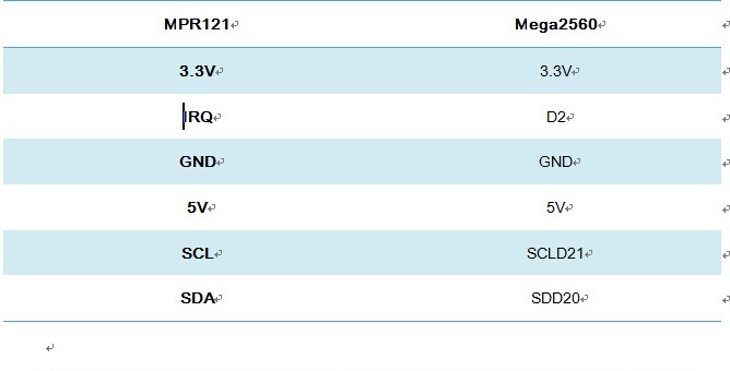

MPR121 touch sensor module can be connected and communicate with PCB whose operating voltage can be both 3.3v and 5v. As mentioned above, the connection method varies when connecting to different PCBs with different operating voltage. Here we set it as an example to connect it with Mega 2560.
[[File:Mega 2560 and mpr.jpg]]
