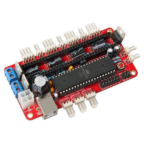

[[File:Sanguinololu1.jpg|500px|]]
Sanguinololu is a low-cost all-in-one electronics solution for Reprap and other CNC devices. It features an onboard Sanguino clone using the ATMEGA644P though a ATMEGA1284 is easily dropped in. Its four axes are powered by Pololu pin compatible stepper drivers.
Sanguinololu is highly integrated with all the functions that a 3D printer needs. It is of high capacity-price ratio and support Reprap style printer and other CNC devices (Computer numerical control devices). The 4 stepper drivers are completely compatible with A4988 and DRV8825. Sanguinololu adapts developer friendly expansion port supporting I2C,SPI,UART,as well as ADC pins. All 14 expansion pins are reserved to be GPIO as well. Power supply for sanguinololu is also flexible; users can choose ATX-4 power input or the 2pin connector to supply.
The board features a developer friendly expansion port supporting I2C, SPI, UART, as well as a few ADC pins. All 14 expansion pins can be used as GPIO as well.
The board is designed to be flexible in the user's power source availability, allowing for an ATX power supply to power the board, or the user can choose to install the voltage regulator kit for use with any power supply 7V-30V.</onlyinclude>

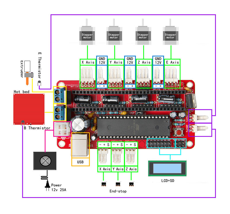

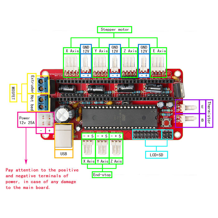

==Interfaces==
;* All through-hole components (except FTDI chip) for easy DIY soldering
===Interface Layout===
</div>
[[File:Langluolu2.jpg|700px]]
==Bugs==
===Interface specifications===
*2 ADC interfaces for thermometry: one for extruder and another for hotbed.

Pay attention to the Plus-n-Minus of power supply, in case the inverse connection may cause damage to the board.

Interface Layout

1. The LED doesn’t light when connected to USB and 5v external power supply.
① LED is broken ②LED is not well welded ③ the power supply doesn’t work.
