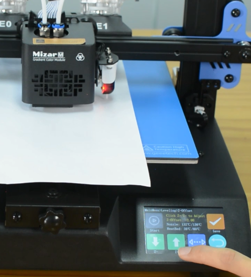

(2) Change the Z-offset
Z-offset is the distance between the nozzle and Z axis home position. A bad Z-offset can cause the nozzle either too close or too far from the hotbed, that will make a bad influence on how PLA is deposited on the bed.

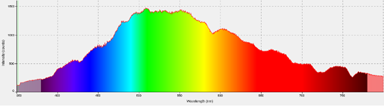

Geeetech Luminous Multicolor PLA is a color change every 13 meters based on the three primary colors of red, green and blue. There will be a color gradient at the intersection of the color change, in which the wavelength of green light (520_570nm) is in the center of the visible spectrum, as shown in the figure below:

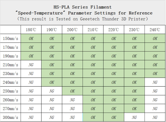

High Speed PLA
High speed PLA has a much faster flow rate than regular PLA before under extruding.
By adjusting the melting point/index, glass transition temperature of raw materials and optimizing the production process, Geeetech enables HS-PLA to have stronger fluidity, smoother discharge, faster curing and forming speed and is not easy to deform under the melting condition.

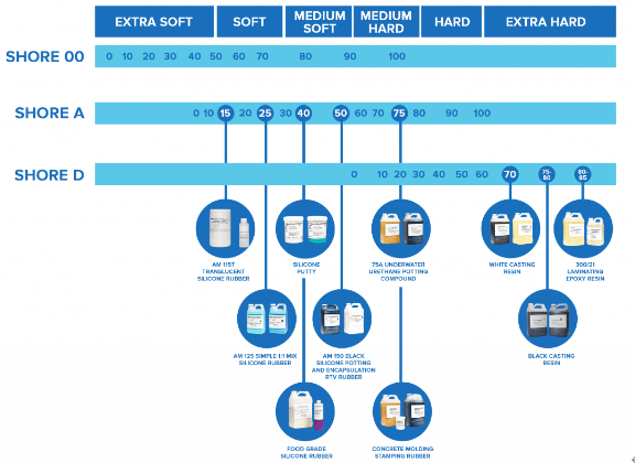

TPU
TPU stands for “thermoplastic polyurethane”. TPU is a specific type of TPE and is on the more rigid than other flexible filaments, making it easier to print with. The Shore hardness value of Geeetech PLA is 95A. You will need TPU if your print always bends, stretches or compresses.
