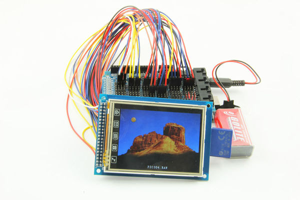

The TFT library is required to be installed to get this screen model display. This library is especially designed for 3.2” TFT LCD screen using 16 bit mode. The library require the following connections.
  • Connect HY-TFT320 to Arduino Mega2560:
LEDA -> 5V
VCC -> 5V
RD -> 3.3V
GND -> GND
DB0->DB7 to pin D37->D30
DB8->DB15 to pin D22->D29
RS -> D38
WR -> D39
CS(pin6) -> D40
RSET-> D41
  • Connect HY-TFT320 to Arduino UNO
LEDA -> 5V VCC -> 5V RD -> 3.3V GND -> GND DB0->DB5 to D8->D13 DB6->A0 DB7->A1 DB8->DB15 to D0->D7 RSET->A2 CS->A3 WR->A4 RS->A5
Note: The TFT controller model needs to be declared in the initializing statement. ITDB02 myGLCD(38,39,40,41) needs to be modified as myGLCD(38,39,40,41,ITDB32S) when using Arduino Mega2560.ITDB02 myGLCD(19,18,17,16,ITDB32S) needs to be commented when using Aduino UNO. Otherwise it just show a blank screen. In practice, RS, WR, CS, RSET can be connected to any free pin. But the pin number must be in accord with myGLCD(RS,WR,CS,RST).

Calibrate the touch screen: The default setting is accurate for 2.4” TFT module, but you need to calibrate when using 3.2” TFT module. A program to calibrate the touch screen is included in the example. If you touch screen is inaccurate, you need to run touch_calibration. Follow the on-screen instruction to calibrate the touch screen. Better not use your finger to calibrate it, use your accessory touch pen to pressure the frontsight with stength. Then record the calibration parameters and apply them in ITDB02_Touch.cpp in your touch screen library.
SD Card:
There is built-in SD card slot in the shield, so we can use it to upload images. But the images need to be converted RAW format first. SD libraries tinyFAT and tinyFAT_16 need to be preinstalled for displaying the image.
Note: The library only supports FAT16 fomatted SD card up to 2GB, so you need to fomat your SD card to FAT16. 4GB FAT16 fomatted SD card is tested not working. Long file names are not supported. Keep your file names compliant with 8.3 standard.
