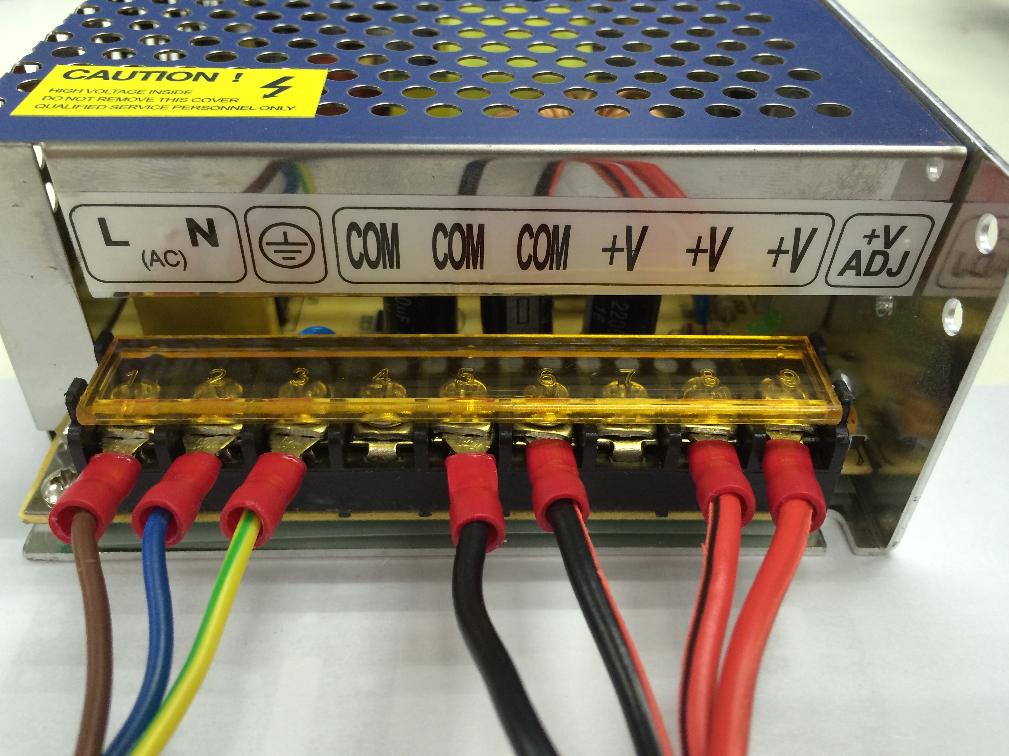

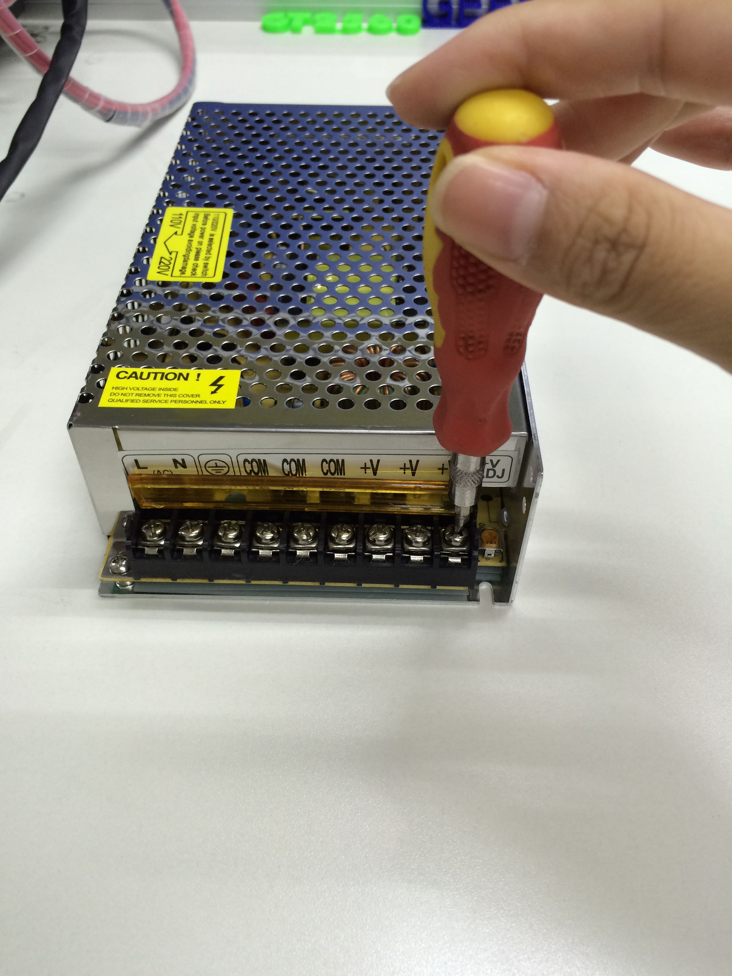

connect power supply
1.Take out the powersupply unit, check the condition of it and check it is 220V or 110V, you can switch it according to your real situation. this is very inportant.
2. Loose the screws on the connector,then screw the wires up in order, you can refer to the color of the wire, as shown in the following picture.
L -- brown
N -- blue
GND -- yellow
COM -- black
+ V -- red
