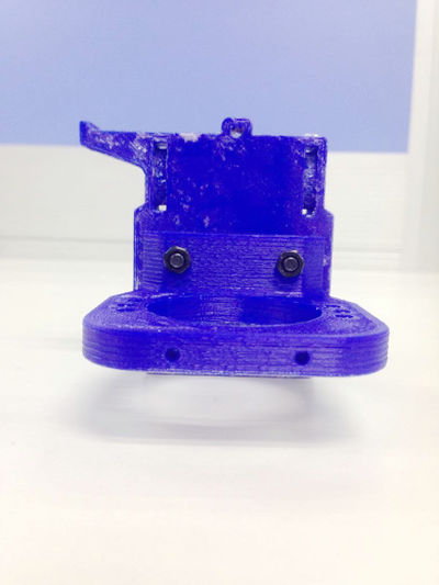

Mount the extruder support
Required parts Required number Part ID
Extruder bracket
1
NO.P4
M4 x20 screw
2
NO.34
M4 lock nut
2
NO.14

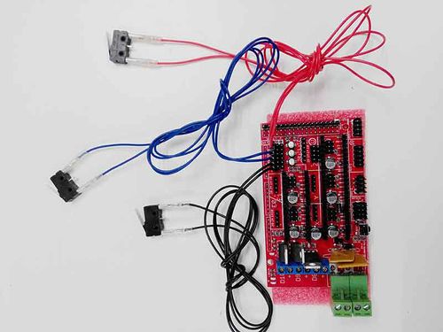

Mount the end stops
Step 1.End stop of X-axis
End stop
1
NO.44
M2.5 x12 screw
2
NO.21
Step2. End stop of Y-axis
End stop
1
NO.45
M2.5 x16 screw
2
NO.22
M2.5 Hex nut
2
NO.10
Step3. End stop of Z-axis
End stop
1
NO.46
M2.5 x16 screw
2
NO.22

Example 2: Ramps 1.4
Step1.Plug the jumper caps on ramps 1.4. You need 15 jumper caps in total.
Step2.Stack ramps 1.4 onto mega 2560.
Plug the 4 A4988 motor driver boards on ramps1.4; stick the heat sinks on the driver boards.
(one for X, one for Y, one for extruder, two for Z)
Mind the directions of the driver boards. You can see the “GND” on the board.
Wiring
The referring wiring schematic diagram of Ramps 1.4
1.Connect motors. X and Y motors are easier, here you need to notice the Z motor, you need two 4-pin DuPont cable to extend for 2 Z motors.
2.Connect the fan; both the fan for extruder and the main board are connected like this. As to the fan for extruder, you need another 2-pin DuPont cable to extend. Take off the adapters and plug the cable into the power port.
3.Connect the heatbed.
4.Connect the extruder
The 2-pin DuPont cable with adapter is for thermometry, the thicker one is for heating.
5.Connect the end stops.
6.Connect the power supply.
First you should take off the white adapter.
Then screw the cable into the power port. Notice the “+” and “-“ Red is “+”. Black is “-“.
Plug the other end into the PSU.
For more information about ramps 1.4, please visit the ramps 1.4 wiki.
