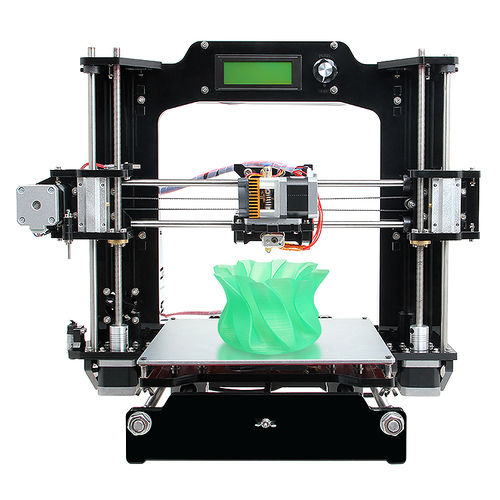

Acrylic Prusa I3 build instruction(8mm)
Warning:
  1. This kit contains tiny parts; please keep them away from kids under 3.
  2. Building and operating 3D printer involves electricity, so all necessary precautions should be taken and adhered to.
  3. Building a 3d printer requires a certain amount of handling ability and some common sense and working principle of 3D printer.
However, do not worry; with this build instruction in hand, you can finish the assembly easily.

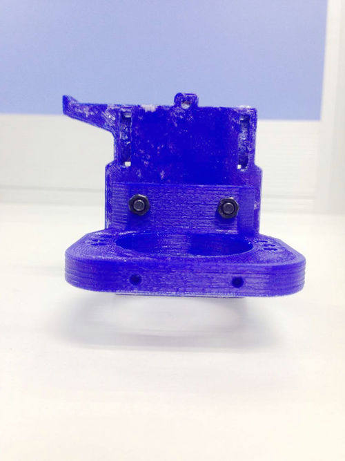

Extruder bracket
1
NO.P4
M4 x20 screw
2
NO.34
M4 lock nut
2
NO.14

The whole printer assembly work is already done.
Hope you enjoy the whole process.
