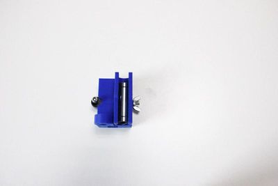

Assemble the Y idler
Required parts Required number Part ID
624ZZ Ball bearing(front)
2
NO.37
Y belt holder
1
NO.65
M3 x20 screw
1
NO.27
M3 wing nut
1
NO.15
M3 x25 screw
1
NO.34
M4 lock nut
1
NO.14

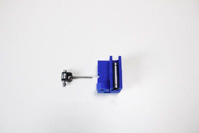

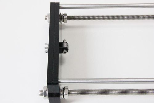

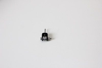

Step1. Thread the M3 x 20 screw through the Y idler piece.
Put the M4 x25 screw through the holes with the 624ZZ bearings in between. Lock the other end with a M3 nut.
Step2. Mount the assembled idler onto the front support plates. And screw it with a wing nut.
*Please leave enough room for the belt between the ball bearing and the screw.

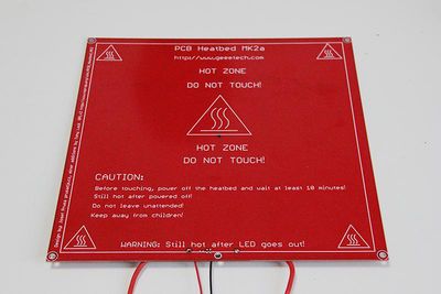

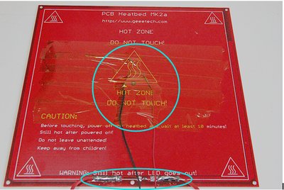

Step5. Attach he heated bed.
You can also attach the heat bed later.
Heat bed
1
NO.71
Borosilicate glass
1
NO.72
Heating wire
2
NO.50
Thermistor
1
Attached on the bed
Themometry wire
2
NO.49
Wing nut
4
NO.15
Spring
4
NO.36
M3 x30 screw
4
NO.28
clamp
4
NO.52
*The circled part needs soldering.
Mount the heat bed on the platform with 4 M3 x30 screws and wing nuts with springs in between. Clamp the heat bed and the glass sheet.

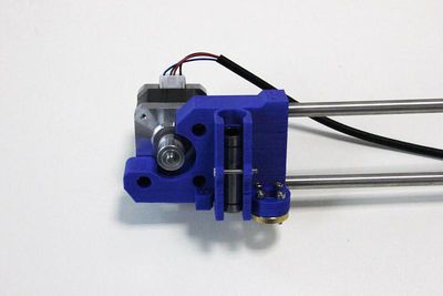

Assemble the X-Axis Idler
624ZZ Ball bearing
2
NO.37
X belt holder
1
NO.65
M3 x30 screw
1
NO.28
M4 x25 screw
1
NO.34
M4 lock nut
1
NO.14
M3 Wing nut
1
NO.15
X-axis end
2
NO.P2
LM8UU linear bearing
2
NO.39
Put the screw through the printed Y idler piece, with the 624ZZ bearings in between. Lock the other end of a M3 nut.
Mount the assembled idler into the X-axis end. Lock it up with a wing nut. Here, you can insert the linear bearing into the end.
Insert a linear bearing into the other end of X-axis.

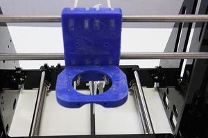

Mount the extruder on the X axis
Thread the zip-tie through the extruder bracket
belt bracket
1
NO.P3
Zip tie
4
NO.53
Step1. Mount the X-axis belt bracket on the smooth rods. As you can see from the picture, the two linear bearings should be placed into the two slot of the bracket. Tie them up with zip ties.
Mount the extruder support
Extruder bracket
1
NO.P4
M4 x16 screw
2
NO.33
M4 lock nut
2
NO.14

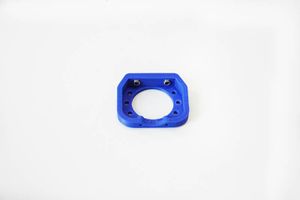

Mount the extruder
MK8 extruder
1
NO.78
MK8 assemble board
1
NO.64
M4 x8 screw
2
NO.31
M4 x12 screw
2
NO.32
This is the fully assembled MK8 extruder in the package.
Take the nozzle part and the bolt out.
Mount the aluminum plate under the extruder. Use 2 M4 x 8 screws to fix.
Then mount the assembled extruder on the extruder bracket. Use 2 M4 x 16 screws to fix.

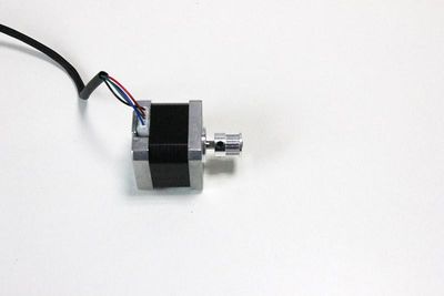

Mount the X-axis motor
Stepper motor
1
NO.74
Pulley
1
NO.42
M3 x8 screw
3
NO.23

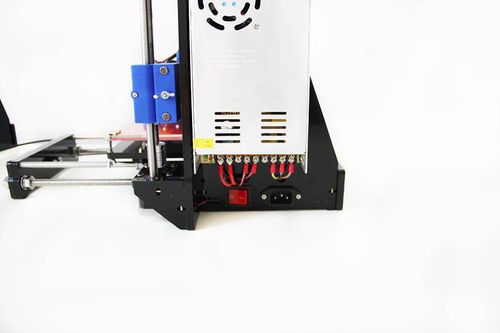

Mount the PSU
PSU
1
NO.73
M4 x12 screw
4
NO.32
M3 x20 screw
2
NO.27
M3 nut
2
NO.11
Power cable
1
NO.61
Mount the PSU on the right side panel with 4 M4 x 12 screws.
Then mount the AC socket with M3 x 20 screws.
You have to take off one end of the connectors to get both the power button and the power socket into the hole.
1. Mind the color of the wires. The wrong connection of the wire will cause serious damage to the PSU and even to the control board of the printer.
2. Pay attention to the switch on the right side of the PSU, there are two options of voltage: 110 V and 220V, choose according the standard in your country. As shown in the following picture.

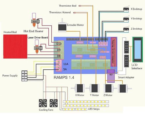

PS: The referring wiring schematic diagram of Ramps 1.4
For more information about ramps 1.4, please visit the ramps 1.4 wiki.
