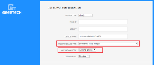

Settings of Iduino
Click SENSORS button and enter the settings relate to Iduino
Arduino board Type: Define the setting of bootloader/mcu type/fuse during Sketch uploading
Operation Mode: Make sure the mode is Arduino Bridge mode so that the Bridge class can work
