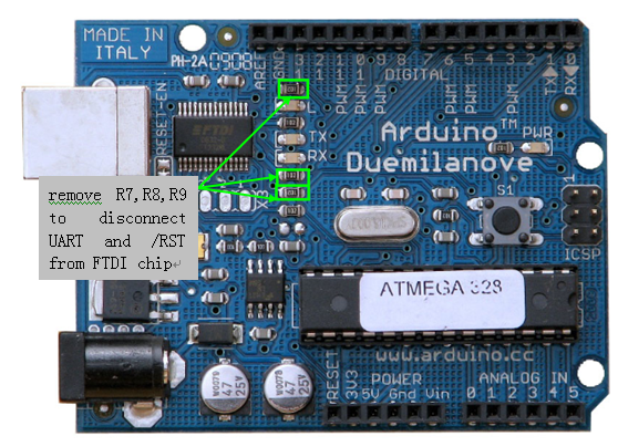

Connect to Arduino Duemilanove/Diecimila
1) The mega avr interface on the Duemilanove/Diecimila is connected to the FTDI chip, and we must disconnect them as the below figure: connect to Arduino Duemilanove/Diecimila
2) Add a “Duemilanove” board type in the file: Arduino\hardware\arduino\avr\board.txt. User can use the Uno Yun board type if there is mega328P. For mega328/mega168/mega168P, they can modify the upload.maximum_data/upload.maximum_size and build.mcu accordingly.
3) Plug the Iduino_Yun_Shield on the Duemilanove and power it via DC jack.

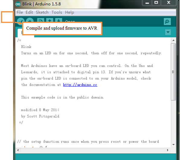

Upload Sketch
1) In the Arduino IDE, choose correct board type for AVR module.
2) In the Arduino IDE, choose correct port (may be the address of Arduino Yun).
3) In the Iduino_Yun_Shield GUI>Sensor page, choose correct board type for uploading.
4) Compile and upload sketch to Arduino board. During uploading, the Iduino_Yun_Shield will ask you to input the password, which is “iduino” by default.

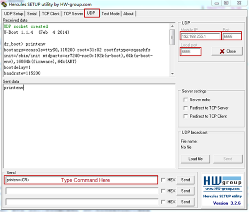

Download Hercules utility
Download Hercules, which is a tool used to transfer commands to Iduino_Yun_Shield under Failsafe mode. Run Hercules and input correct parameters as below:
Protocol: UDP
Module IP: 192.168.255.1
Port: 6666
Local Port: 6666
Connect the PC to Iduino_Yun_Shield
Connect the PC to Iduino_Yun_Shield via Ethernet cable. Set up PC with below LAN IP 192.168.255.2 and subnet mask 255.255.255.0. Disable PC’s firewall.
Power up Iduino_Yun_Shield to Failsafe mode
Press the Failsafe button and power up Iduino_Yun_Shield, and you will see all the LEDs blink together. Release the button after 10 seconds and some messages will pop up in the Hercules panel, which means the Iduino_Yun_Shield has been in Failsafe mode and ready to access commands.
You can type the commands to Hercules to transfer and update Iduino_Yun_Shield to the latest firmware.
The update commands are as below; replace the xxx with actual version.
Note when typing commands to Hercules: user must add <CR> at the end of each command; $ is a special char in Hercules, user should double it (key 2 $) when typing.

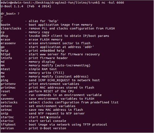

Recover in Linux is similar with Windows. The different is that the tool used in Linux is nc, namely nc-kul6666. The figure below shows that the Iduino_Yun_Shield has been in Failsafe mode and detected by nc.
reset firmware
