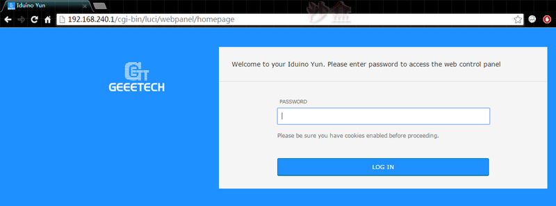

Use browser (recommend Firefox or Chrome) to set Iduino_Yun_Shield, and you will see login page after entering 192.168.240.1.
Default password for Iduino_Yun_Shield is ‘iduino’.

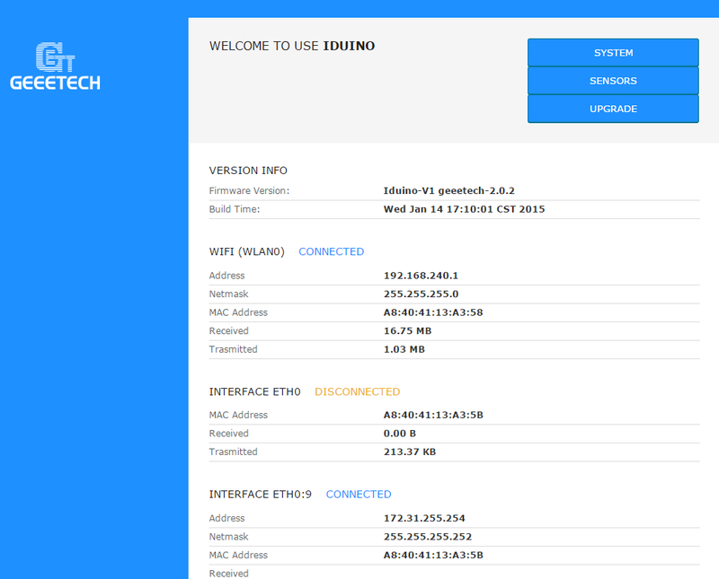

After login, the GUI will show the WIFI/ETH status.
Click the SYSTEM button, and you can set the device password and parameter.
