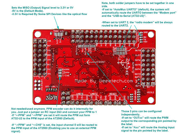

1. Adapts PPM decoder chip- Atmega32U2 to take charge of the surveillance and controlling of PWM signal of mode channel so as to switch between manual mode and other modes, thus improving the security of the whole system.
2. The directional data provided by the inertial measurement unit (two-axis gyro and single-axis gyro) and triaxial accelerometer (to measure the speed of three axes and accelerate the speed), cooperating with the three axis magnetometer or GPS can be corrected to realize directional cosine algorithm and calculate the attitude of aircraft.
3. Integrated with MPU6000 (three-axis gyroscope + triaxial accelerometer), MS5611 berometer and HMC5883L three axis electronic compass.
4. Supports data transmission to realize the remote receiving of real-time data from the aircraft.
5. Supports pan-tilt control technique of professional cameras to ensure anti-vibration aerial photograph.
6. Supports airspeedometer to measure the airspeed of aircraft.
7. Supports airspeedometer to ensure stable flight and low voltage protection of voltage detection in real time.
8. Integrated with 12-bite high-precision AD chip which can convert the analog voltage output by airspeedometer and the temperature output by three-axis gyroscope, triaxial accelerometer and dual-axis gyroscope into digital value.

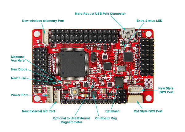

Hardware Specification
APM2.52 Hardware Configuration
  • ATMEGA2560 microcontroller
  • MPU6000 3-axis gyroscope and 3-axis accelerometer
  • MS5611 pressure sensor
  • HMC5883L 3-axis Magnetometer
NOTE:
Your APM 2.5 board is designed to be powered by the included Power Module via the Power Port connector. You can, however, power it from an ESC or some other external 5v source, although that can be less reliable. If you do choose to use an alternative power source, you need to put the little jumper that came in the bag on JP1 pins, next to the "new diode" marked at the left above. If you are not powering the board from an external source, the JP 1 jumper should be off (this is the normal configuration) If you want to explore other alternative power schemes, a guide is in the Appendix here.
