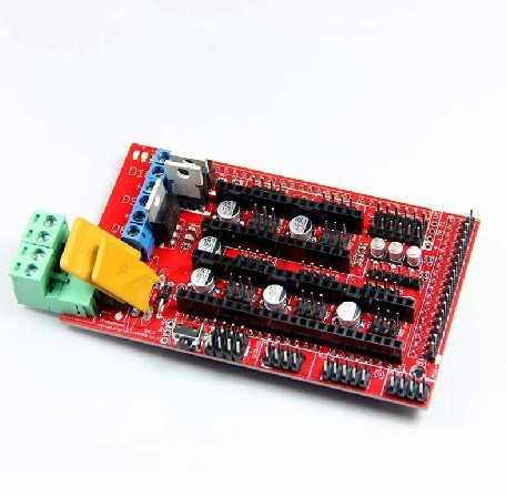

In RAMPS 1.4, the resistors and capacitors are now surface mount to fit more passive components. This does add another set of steps to assembly, but we stuck with larger sizes to make it fairly painless.
Features
  • It has provisions for the cartesian robot and extruder.
  • Expandable to control other accessories.
  • 3 mosfets for heater / fan outputs and 3 thermistor circuits.
  • Fused at 5A for additional safety and component protection
  • Heated bed control with additional 11A fuse
  • Fits 5 Pololu stepper driver board
  • Pololu boards are on pin header sockets so they can be replaced easily or removed for use in future designs.
  • I2C and SPI pins left available for future expansion.
  • All the Mosfets are hooked into PWM pins for versatility.
  • Servo style connectors are used to connect to the endstops, motors, and leds. These connectors are gold plated, rated for 3A, very compact, and globally available.
  • USB type B receptacle
  • SD Card add on available -- Available now made by Kliment - Sdramps
  • LEDs indicate when heater outputs on
  • Option to connect 2 motors to Z for Prusa Mendel

Soldering RAMPS 1.4 includes both surface mount and through hole soldering.
The surface mount can be done a few ways. Since all the SMT components on this board are large 2 pad parts you can do pin by pin soldering pretty easy with normal soldering equipment. Start by putting a small amount of solder on one pad. If you have flux, coat the soldered pad. Use the tweezers to hold the component down in position and heat the solder to tack the component into place (make sure the entire solder blob flows so you don't get a cold solder). Then solder the other pad. Also popular is using solder paste for pad by pad soldering, Oven Reflow (need link), and HotplateReflowTechnique
Solder the SMT components first. Then the PTH on top of the board. Finally solder the pin headers on the bottom.

Solder 1 1x6, 6 1x4, and 7 2x3 pin headers on top of the board. The long post should be standing up to take a connector. Solder one leg on each one to tack them into place. Then re-heat the joint and push on the component until it is perfectly situated. Then you'll want to solder the rest of the leads. You will get burnt if you touch the other side of the pin you are soldering.
If you want to use the extra pin outputs, now is the time to solder on the rest of the headers.
Driver sockets
File:RAMPS1-3 DrSockets.JPG
Place the female headers for the stepper drivers on top of the board. You can use the 1x8 and 1x6 pin headers to jig them straight. Turn the board over and solder these pins.
D1, D2 - Diodes
File:RAMPS1-3 DnF.JPG
Where to find the D1 and D2 diodes
These must be placed in the proper orientation. The band on the diode must be turned the same way as the mark on the board.
Definitely solder D2 in. D2, F1, and F2 are shown installed here.
D1 should only be installed if the 5A rail is powered by 12V. It can be omitted and the Arduino will be powered from USB. You will want D1 installed if you add components to print without a PC. To reiterate, D1 MUST be omitted if you are powering the 5A rail by more than 12V, or the power is not absolutely clean, otherwise you may damage your ramps.
F1 - MFR500 Fuse
This is the smaller yellow fuse. This can be placed in any orientation. When soldering the fuses it is best to use a piece of 3mm filament or something similar to keep the ceramic coating on the pins from blocking proper solder along the through hole.
Since the fuses are the tallest parts, it is simpler and more convenient to solder them last. From this point on, solder the rest of the RAMPS in order of bottom pins, reset switch, terminals, mosfets and then fuses.
Bottom pins
File:RAMPS1-3 bpins.JPG
File:DSC 0148.JPG
Place these on the bottom of the board with the long post out to plug into the Arduino MEGA. You can plug them into the MEGA to hold them in place while you solder. Do not overheat the pins while in Arduino or you may damage it's connectors.
Reset switch
File:RAMPS1-3 rst.JPG
This can only be oriented in one direction.
Mosfet Terminal
File:RAMPS1-3 6pos.JPG
Standard RAMPS 1.4 D8-10 Terminal Block
File:RAMPS1-4 6pos alt.png
Alternative Plug/Jack Connectors
This must be oriented where the wire holes are turned towards the edge of the board. Solder a pin on each end and make sure the component is flat on the board and solder the middle pins.
Power Terminal
File:RAMPS1-3 4pos.JPG
Q1, Q2, Q3 - Mosfets
File:RAMPS1-3 mosfet.JPG
These must be orientated as in the picture. The tall heat sink part of the mosfet needs to be turned the same as the mark on the board.
F2 - MFR1100 Fuse
This is the larger yellow fuse. This can be placed in any orientation.
Inspection
File:RAMPS1-3 fin.JPG
Inspect your work. Clean any solder bridges and suspect solders.
