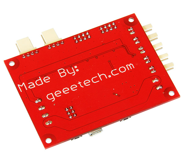

Brainwave is a low cost controller for Reprap 3D printers derived from the well known Sanguinololu. The primary design goal was lower cost, achieved by providing only the minimum required components for a single extruder printer. It can be used to drive a cartesian or delta style printer.
Features:
  • Small footprint: only 60mm x 79mm!
  • 12V power input
  • Micro USB connector
  • All connectors at edge of board, vertical or right-angle connectors will fit.
  • Atmel AT90USB646 microcontroller w/ USB bootloader
  • 1, 2, 16 or 32x microstepping @ up to 800mA
  • Dual Z-axis connectors
  • Optional per channel current attenuation
  • Heated bed support with separate power input (up to 24V @ 15A)
  • Integrated heater/thermistor/stepper connector for E channel
  • Fan control
