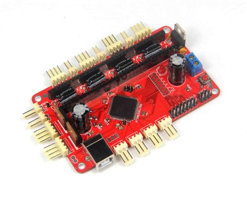

Introduction
This is a project that is based on Sanguinololu. The ATmega644P has been replaced with an Atmel AT90USB1286 MCU. This Microcontroller has on-chip USB, removing the need for the FTDI USB UART. The AT90USB1286 on the board has been preinstalled LUFA CDC bootloader which allows you to upload the firmware through USB cable direc. All of the through hole resistors and capacitors have been replaced with 0805 SMT components. Like the Sanguinololu the Teensylu has expansion headers supporting I2C, SPI, UART, and ADC pins. All extra I/O ports of the AT90USB have been broken out to headers for prototyping.
Features
  • Small design - board is 100mm x 60mm
  • Teensylu clone, Atmel's AT90USB1286
  • Up to 4 A4988/4983 stepstick or Pololu stepper driver boards on-board (X,Y,Z,Extruder)
  • Supports multiple power configurations (Carried from Sanguinololu)
    • Logic & Motors supplied by ATX power supply (needs molex harddrive connector, and optional 4pin atx connector for additional 12v)
    • Motors supplied by 5mm screw terminal 7-35V
    • Logic supplied by USB bus
    • Logic supplied by optional on-board voltage regulator (molex harddrive connector cannot be installed at the same time)
    • on-board USB connectivity
  • 2 thermistor connectors with circuitry
  • 2 N-MOSFETs for extruder/bed heaters
  • 1 N-MOSFET for low power fan or motor
  • Selectable 12v/5v endstop voltage
    • 4 endstops including 4th stop called E-Stop to be used as an emergency stop, or extruder stop (to be added in firmware).
  • 14 Extra pins available for expansion and development - 6 analog and 8 digital (Fully compatabile with Sanguinololu), with the following capabilities
    • UART1 (RX and TX)
    • I2C (SDA and SCL)
    • SPI (MOSI, MISO, SCK)
    • PWM pin (1)
    • Analog I/O (6)
  • Additional 14 pin header with 11 I/O for prototyping
  • SMT Components sized at 0805 for easier soldering.

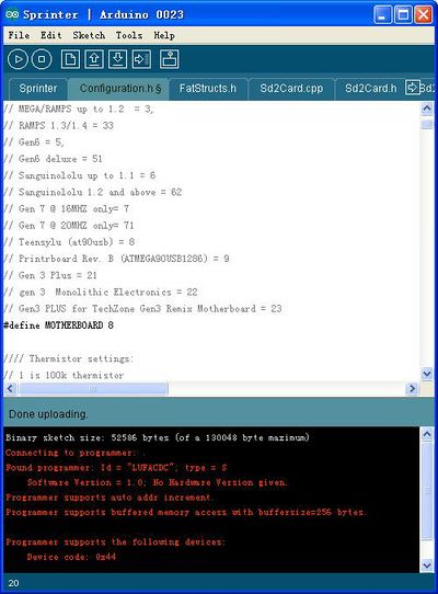

Building and Programming the Firmware (For LUFA CDC bootloader)
  • Download the arduino environment and install. http://arduino.cc/en/Main/Software
  • Download the Teensyduino library from pjrc and install. Be sure to select "all" when asked which additional libraries to install
  • Replace the avrdude.exe located in arduino-0023\hardware\tools\avr\bin with this version avrdude() and better backup the original avrdude.exe which has been replaced, otherwise uploading error will appear.If you have installed the Teensyduino library in Arduino 1.0 or higher version, skip this step
  • Add the following to arduino-xx/hardware/teensy/boards.txt file at the bottom:
cdcteensylu.name=[BootloaderCDC]Teensylu/Printrboard
cdcteensylu.upload.protocol=avr109
cdcteensylu.upload.maximum_size=130048
cdcteensylu.build.mcu=at90usb1286
cdcteensylu.build.f_cpu=16000000L
cdcteensylu.build.core=teensy
cdcteensylu.build.define0=-DUSB_SERIAL
cdcteensylu.build.define1=-DLAYOUT_US_ENGLISH
cdcteensylu.upload.speed=115200
  • Download Sprinter firmware. https://github.com/kliment/Sprinter
  • Open Sprinter in arduino and configure configuration.h file.
  • Motherboard should be set to 8: #define MOTHERBOARD 8
  • Turn off endstops if you didn't install endstops: const bool ENDSTOPS_INVERTING = true;
  • Turn comment out SD card support, not working yet: //#define SDSUPPORT
  • Remove the HWB jumper on the board to boot into the bootloader.
  • Connect the USB cable to Teensylu, the virtual serial port appears. Remember this Serial port number, because this port is only for communication, not for programming.
  • Push the Reset button, the serial port number changes. This serial port is what we want for programming the firmware.
  • Select the board Teensylu/Printrboard and uploding your firmware.
  • After the uploading is done, replace the HWB jumper and push the reset button.
