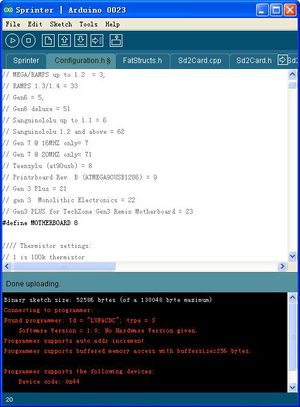

  • Download Sprinter firmware. https://github.com/kliment/Sprinter
  • Open Sprinter in arduino and configure configuration.h file.
  • Motherboard should be set to 8: #define MOTHERBOARD 8
  • Turn off endstops if you didn't install endstops: const bool ENDSTOPS_INVERTING = true;
  • Turn comment out SD card support, not working yet: //#define SDSUPPORT
  • Remove the HWB jumper on the board to boot into the bootloader.
  • Connect the USB cable to Teensylu, the virtual serial port appears. Remember this Serial port number, because this port is only for communication, not for programming.
  • Push the Reset button, the serial port number changes. This serial port is what we want for programming the firmware.
  • Select the board Teensylu/Printrboard and uploding your firmware.
  • After the uploading is done, replace the HWB jumper and push the reset button.
