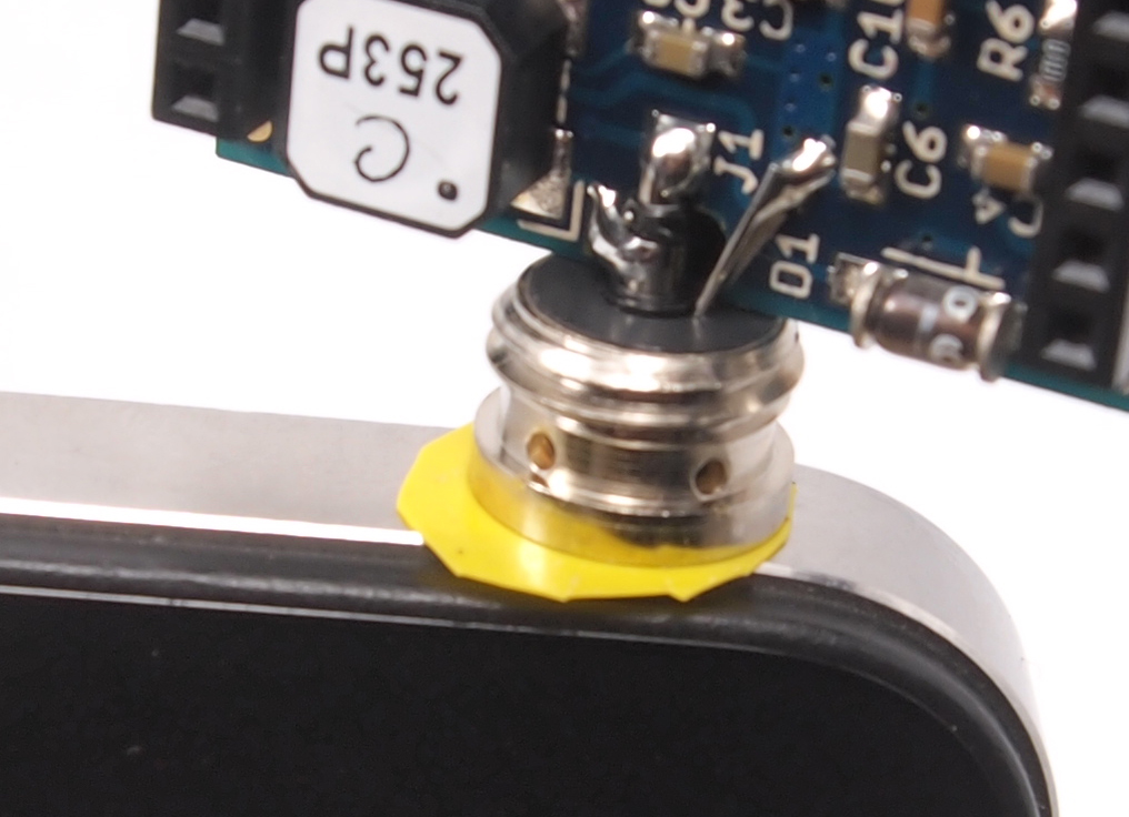

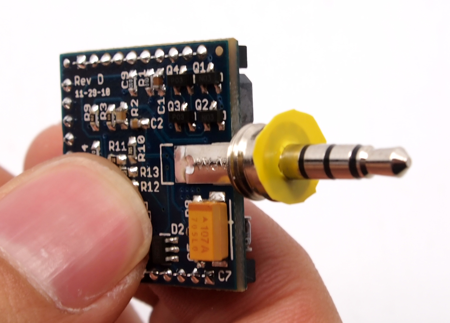

==Bug Tracker== Because of the connector we used in last batch can not be found in market, we have transferred to the original hijack version, which we found a fatal bug in the connector. In case of using with Iphone4&4S, Because the MIC Pin of audio connector touches shell of Iphone4&4GS, a insulating washer needs to be used to avoid this fatal bug, as the following:

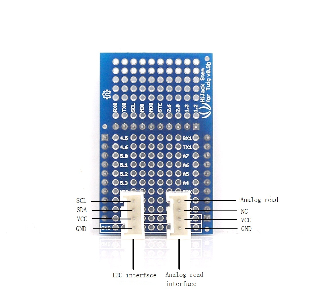

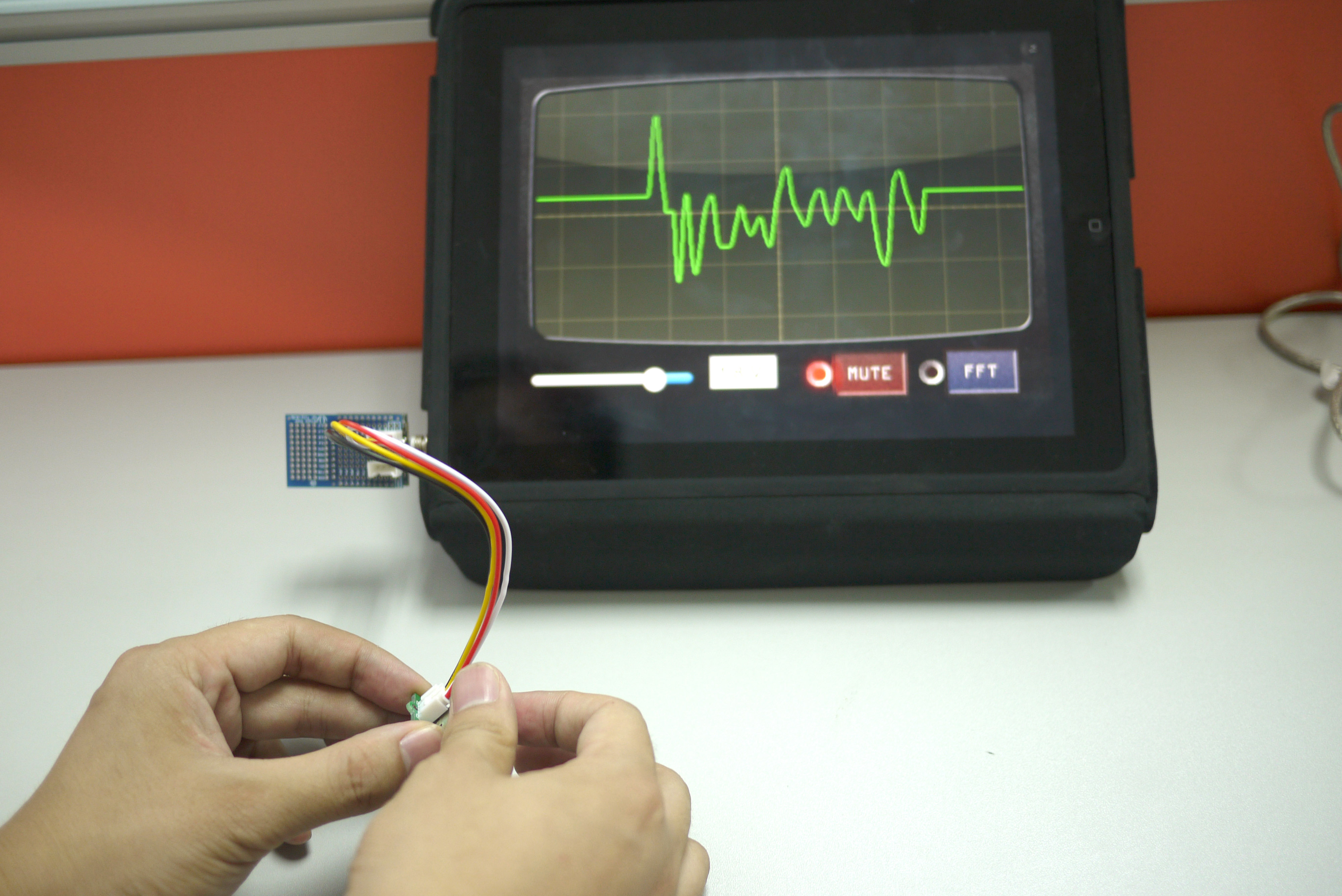

1.connect the twig_Potentiometer to the analog read interface of the HiJack ProtoBoard, and then insert it to the Hijack mainboard.
2.Insert this kit into the audio connector to iPhone/iPad/iTouch.
3.Turn up the volume of iPhone/iPad/iTouch, and open the app: Hijack.It is a app which you can download from the app store for free.]

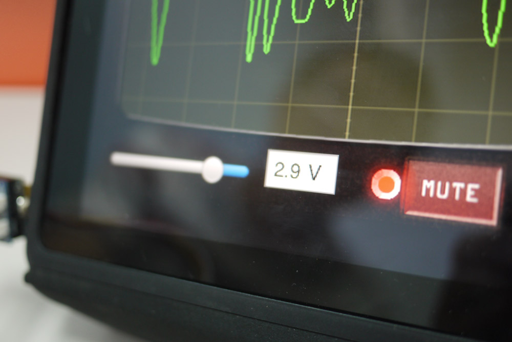

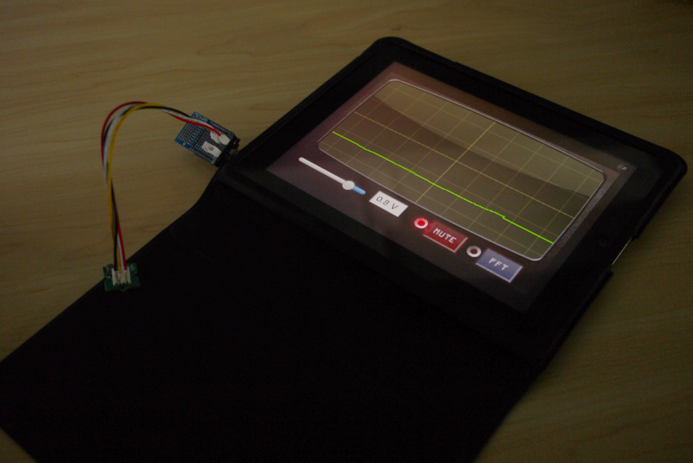

The MCU on the Hijack mainboard A/D convert the voltage on the Potentiometer , and then sent the result to the iPad via audio connector. Rotate the Potentiometer, you will see the waveform on the iPad changes with your rotating. And, the voltage result showed at the bottom of iPad changes.

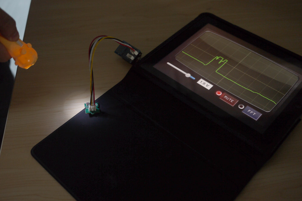

example 2 Connect the twig-light sensor to HiJack ProtoBoard, the waveform on the iPad changes because light sensors which change voltage based on the light of the environment.You can see from the pictures,the leftside one shows the low voltage about 0.8v because light sensor is in the dark place.The other one shows the 1.9v voltage because it is exposed to the light source.
