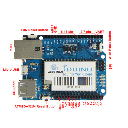

interface explanation

USB Ports
The Iduino Yun Cloud has two USB connectors for different purpose:
  • USB Type A Female: Connect to the Linux part. it is a USB host port. User can use it to connect to USB flash, 3G dongle etc.
  • USB micro A Female: Connect to Atmega32u4, use can use it to upload sketch to Atmega32u4 or get debug info from 32u4.
Buttons:
  • WLAN_RESET: Reset Linux part.see here
  • 32u4_RSET: Reboot Atmega32u4
  • YUN_RST: Reboot Linux part
