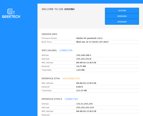

After login, the GUI will show the WIFI/ETH status.
[[File:General setting1.png|400px|]]
[[File:General setting1.png|500px|]]

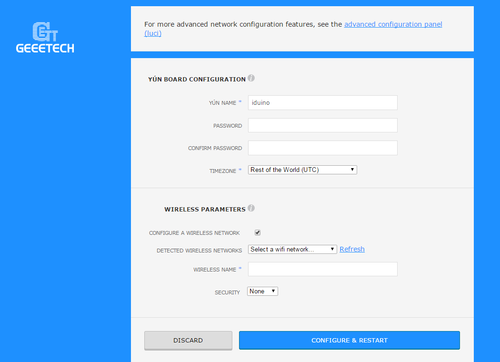

Click the SYSTEM button, and you can set the device password and parameter.
[[File:General setting2.png|400px|]]
[[File:General setting2.png|500px|]]

General setting
