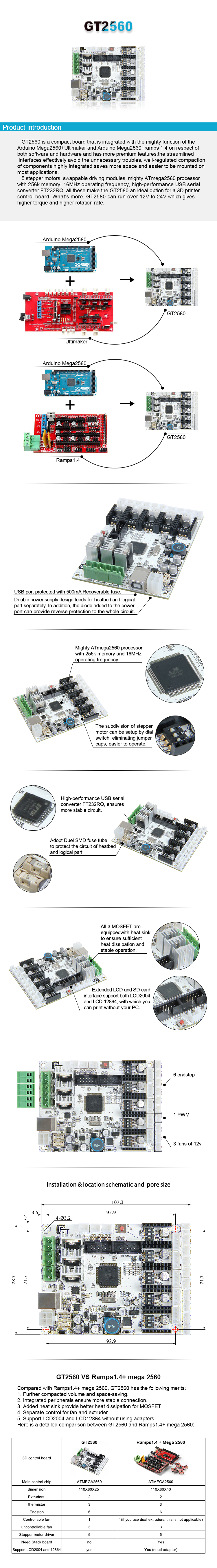

Introduction
GT2560 is a compact board that is integrated with the mighty function of the Arduino Mega2560+Ultimaker and Arduino Mega2560+ramps 1.4 on respect of both software and hardware and has more premium features: the streamlined interfaces effectively avoid the unnecessary troubles, well-regulated compaction of components highly integrated saves more space and easier to be mounted on most applications.
5 stepper motors, swappable driving modules, mighty ATmega2560 processor with 256k memory, 16MHz operating frequency, high-performance USB serial converter FT232RQ, all these make the GT2560 an ideal option for a 3D printer control board. What’s more, GT2560 can run over 12V to 24V which gives higher torque and higher rotation rate.
Features:
1.Integrated with the mighty function of the Arduino Mega2560+Ultimaker and Arduino Mega2560+ramps 1.4 kit, The GT2560 can not only take full place of them on respect of both software and hardware, but also features compact size, more convenient connection, and more stable.
2. Adopt ATmega2560 as the main control chip, coupled with the high-performance USB serial converter FT232RQ.
3. The power pack: operating voltage is 12V-24V; double power supply design provide for heatbed and logical part separately,overcurrent protection is also provided.
4. The main circuit adopts SMD fuse tube, the diode added to the power port can provide reverse protection to the whole circuit, in addition, the 5V USB is USB port protected with 500mA Recoverable fuse.
5.3 12v fan output and one PWM output for LED or other lighting equipment.
6. 3 55Amp MOSFET (with LED indicator, the actual output is restricted by the PCB board and the connector), all 3 MOSFET are equipped with heat sink to ensure sufficient heat dissipation and stable operation.
7. Support 5 A4988 stepper drivers (3 for X/Y/Z axis, and 2 for extruders); the subdivision of stepper motor can be setup by dial switch, eliminating jumper caps, easier to operate.
8. 3 temperature sensor input (100k thermistor is recommended)
9. Extended LCD and SD card interface support both LCD2004 and LCD 12864, with which you can print without your PC.
10. The firmware is the prevalent Marlin, which is known for stability, usability, and high-performance.
Overview and Hardware Resources
Hardware resources:
12V/24V 15A and 12V/24V 10A power supply
1 power port for heatbed and 2 for extruder
5 stepper motor input, (3 for X/Y/Z axis, and 2 for extruders)
Extended LCD & SD card interface
6 endstop input(X-MIN ,Y-MIN ,Z-MIN 和X-MAX ,Y-MAX ,Z-MAX)
3 input for thermistor (TEMP1, TEMP2 and TEMP3)
3 input for12V cooling fan
1 PWM output
Dimension: 109mm*78mm*22mm
weight: 87 g
Software Resources
Compiling environment: Arduino IDE
Firmware: Marlin
