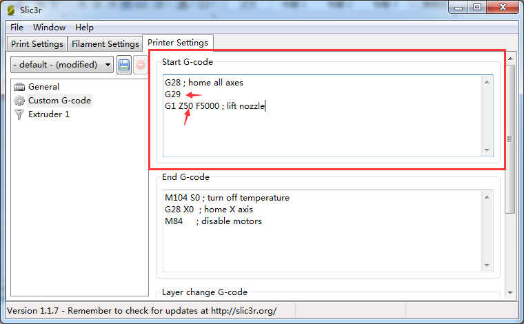

Start G29 Command
Thoughg we have added an auto-leveling probe for the Rostock mini, but generally there is no G-gode in the sli3er, so we need to add the G29 command to the sli3er.
Step1. Start G29 command in Slic3r.
Click Slicer and configure, waiting for a minute till the slicer window prompt up.
Step2. Choose printer setting-- Custom G-code.
You can see from the start G-code, there is no G29.
So you need to add the G29 after G28 to start it. And change Z5 into Z50.
Save the current printing setting, click “OK” to continue.
