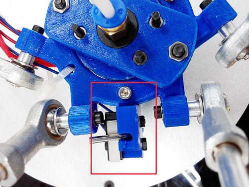

Assemble the automatic leveling.
The automatic leveling part is pre-assembled; you just need to mount it on the spider. Screw it up with M3x 20 screw

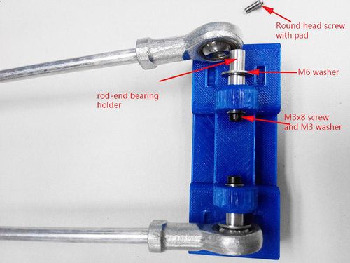

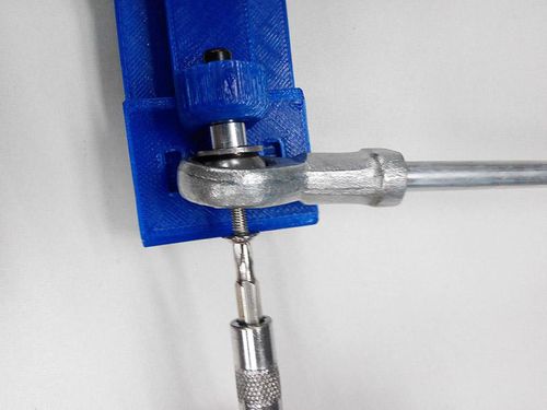

Step1. Mount the diagonal rod onto the carriage.
Step2. Repeat the above steps for the other diagonal rods. And mount another end of the diagonal rods to the spider.
The directions should be as shown in the following picture.

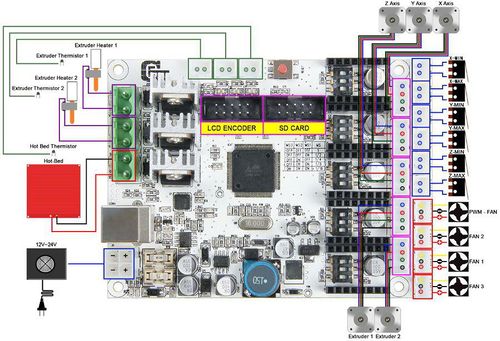

Chapter7 Wiring
Before you start wiring, please take a look at the wiring schematics.
You can see original picture here.
Step1. Connect wires for motors.
1) Connect wires for X-axis motor.
2) Connect wires for Y-axis motor.
3) Connect wires for Z-axis motor.
4) Connect extruder
Step4. Connect heating wires.
Loosed the screws in the green terminal and put the red wires into the slot and screw it up.
* There is no “+” and “-“for heating wires
1) Connect heating wires for heatbed.
2) Connect heating wires for extruder .
Step4. Connect wires for thermistor.
1) Connect wires for thermistor of heatbed.
2) Connect wires for thermistor of extruder 0.
Step5. Connect wires for endstop.
Required parts Part ID Required number
endstop
41
3
1) Connect wires for endstop of X-axis at X-max.
2) Connect wires for endstop of Y-axis at Y-max.
3) Connect wires for endstop of Z-axis at Z-max.
Step6. Connect wires for Fan.
1) Connect fan for control board at FAN1.
2) Connect fan for extruder at FAN3.
3) Connect fan for hotend at FAN-PWM.
Step7. Connect wires for LCD panel.
There are two cables, one is for LCD encoder, the other is for SD card, do not connect them reversed.
Step8. Connect wires for power input.
Power cable
48
1
Plug the other end into the PSU. Do not forget to cover it.
Step9.Connect the power cable to the input connector of PSU
3D Power cable
49
1
As shown in the red box.
That is all for the wiring of GT2560.
