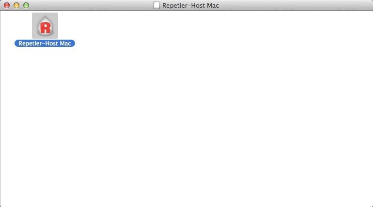

In Mac, you can download Repetier for Mac" at:
[1]
After downloading, open "Repetier-Host-Mac_56.dmg",then you will see the icon of "Repetier Host", open it.
