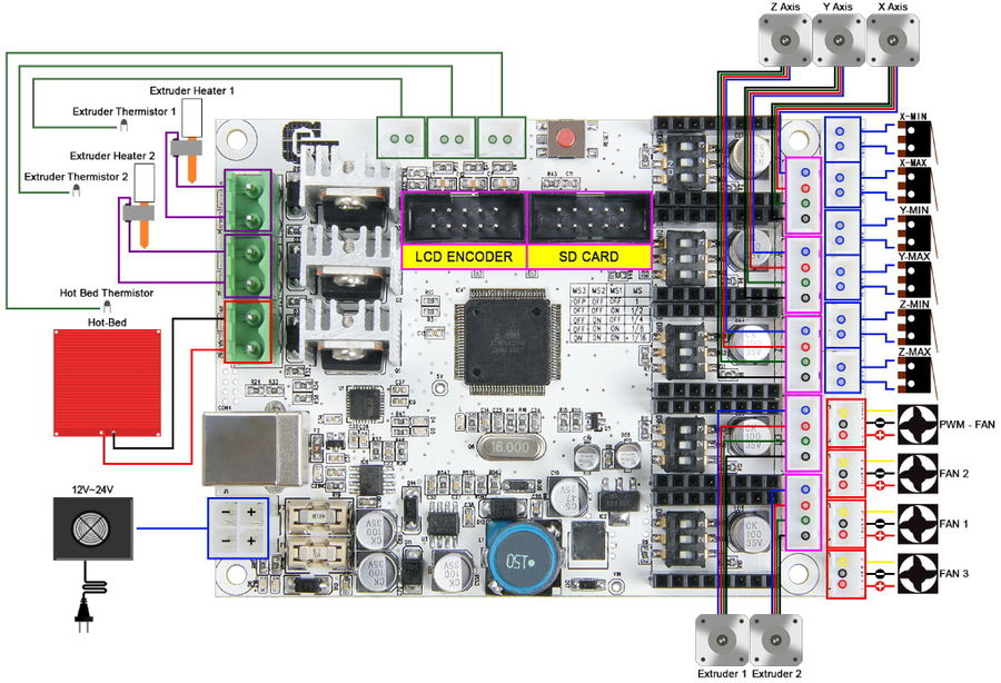

===Step8===
Connect wires for LCD panel.
There are two cables, one is for LCD encoder, the other is for SD card, do not connect them reversed.
[[File:LCD.jpg|500px|]]
===Step9===
Connect wires for power input.
[[File:Power Cable.jpg|500px|]]
Plug the other end into the PSU.
[[File:Power output.png]]
That is all for the wiring of GT2560.

Mount the control board on the left side panel
Before you start wiring, please take a look at the wiring schematics.
There is one thing you need to note that the extruder number in this picture is 1 and 2, but in the following steps, I referred them as 0 and 1 correspondingly.
Step1
The subdivision of stepper motor can be setup by dial switch, turn on all the dial switches.
Step2
Plug the 5 A4988 into the stepper motor driver slot. Mind the directions of A4988.
Step3
Connect wires for motors.
1) Connect wires for X-axis motor.
2) Connect wires for Y-axis motor.
3) Connect wires for Z-axis motor.
Here you need to use the DuPont wire (NO.64).
Plug the end with one terminal into the Z motor slot. And connect the two wires of Z motor to the two DuPont wires separately.
Note the color of the connection as below:
DuPont wires Motor wire!
Red
Blue
Black
Red
Blue
Green
Purple
Black
4) Connect Extruders
As you can see 0 and 1 from the extruder holder [NO.P4], you need to straighten out the two wires and do not mix them up.
Connect extruder 0.
Connect extruder 1.
Step4
Connect heating wires.
Loosed the screws in the green terminal and put the red wires into the slot and screw it up.
* There is no “+” and “-“for heating wires
1) Connect heating wires for heatbed.
2) Connect heating wires for extruder 0.
3) Connect heating wires for extruder 1.
Step5
Connect wires for thermistor.
1) Connect wires for thermistor of heatbed.
2) Connect wires for thermistor of extruder 0.
3) Connect wires for thermistor of extruder 1.
Step6
Connect wires for endstop.
* There is no “+” and “-“for endstop
1) Connect wires for endstop of X-axis at X-max.
2) Connect wires for endstop of Y-axis at Y-max.
3) Connect wires for endstop of Z-axis at Z-max.
Step7
Connect wires for Fan.
1) Connect fan for control board at FAN3.
Note the “+” and “-“for fan
Red: +
Black: -
2) Connect fan for extruder at FAN1.
Step8
Step9
