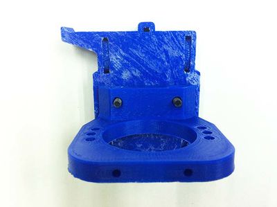

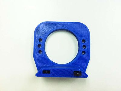

Mount the extruder holder.
Required parts | Required number | Part ID |
Step1.Put the 2 M4 nut into the hole, as shown in the picture.
Step2. Screw up the belt bracket and the extruder support with two M4 x 16screws.
