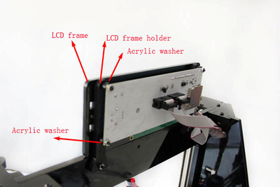

Mount the LCD panel frame
Required parts Required number Part ID
LCD 2004
1
NO.80
LCD frame
1
NO.A21
LCD frame holder
2
NO.A23
Acrylic washer
4
NO.A20
M3 x20 screw
6
NO.27
M3 nut
4
NO.11
