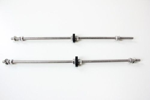

Assemble Y axis (the bottom part of the chassis)
Assemble the rods of a Y axis
Step1. Assemble the 2 threaded rods.
Required parts Required number Part ID
M10 threaded rod
2
NO.5
Y plate connecting plate
2
NO.A14
M8 spring washer
6
NO.18
M10 washer
8
NO.9
M10 nut
8
NO.12
Thread the nuts and washers into the two M10 threaded rods separately. The order should be:
1) Thread the acrylic fender (Y plate connecting plate) in the middle.
2) Thread the M10 washer > M8 spring washer >M10 nut > M10 nut > M10 washer on the left
3) Thread theM10 washer < M8 spring washer < M10 nut < M10 nut< M8 spring washer < M10 washer on the right

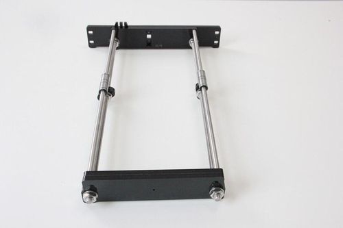

Step2. Assemble the 2 smooth rods
M8 smooth rod
2
NO.3
LM8UU Linear bearings
4
NO.39
Slide 2 bearings on each smooth rod. Before you slide the bearings please make sure they are clean.
Attach the front and rear Acrylic support plates of the rods
Acrylic plate(front)
2
NO.A9,A10
Acrylic plate(back)
2
NO.A11,A12
M10 washer
4
NO.9
M10 nut
4
NO.12
Step1. Slide the rods into the acrylic plate; adjust the length so that the smooth rods fit snugly between the front and rear piece.
Step2. Screw up the rods and plate with M10 nut and M10 washer.
Tips: the Y-axis must be a rectangle, that is the rods on both side should be parallel, so is the front and back plate. Otherwise it will cause obstruction for the belt later. You can use a Digital Caliper to measure. .

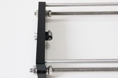

Assemble the Y idler
624ZZ Ball bearing
2
NO.38
bearing holder
1
NO.66
M3 x20 screw
1
NO.27
M3 wing nut
1
NO.15
M3 x25 screw
1
NO.35
M4 lock nut
1
NO.14
Step1. Thread the M3 x 20 screw through thethe bearing holder.
Step2. Put the M4 x25 screw through the holes with the two 624ZZ bearings in between. Lock the other end with a M4 lock nut.
Step3. Mount the assembled bearing holder onto the front support plates. And screw it with a wing nut.
*Please leave enough room for the belt between the ball bearing and the screw.
