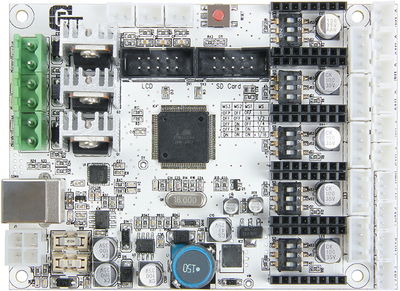

Overview and Hardware Resources
                         (front and back images)
Hardware resources:
12V 12A and 12V 5A power supply
1 power port for heatbed and 2 for extruder
5 stepper motor input, (3 for X/Y/Z axis, and 2 for extruders)
Extended LCD & SD card interface
6 endstop input(X-MIN ,Y-MIN ,Z-MIN 和X-MAX ,Y-MAX ,Z-MAX)
3 input for thermistor (TEMP1, TEMP2 and TEMP3)
3 input for12V cooling fan
1 PWM output
Dimension: 107.3mm*78.7mm*22mm
Weight: 80 g

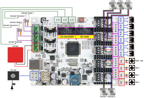

Note:
Pay attention to the Plus-n-Minus of the power connector, reverse connection can cause irrevocably damages.
A4988 should also be connected to the right port, mismatches and revered directions can cause damage to the main board.
The correct connections are as follow:
If you are using DRV8825 instead of A4988, The correct connections are as follow:
3.You are suggested to connect all the Periphery modules before testing.
