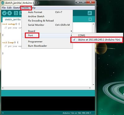

Detect Iduino_Yun_Shield
Make sure your laptop and Iduino_Yun_Shield are in the same network. The Iduino_Yun_Shield will broadcast data in this network and Arduino IDE will show Iduino_Yun_Shield in Tools>Port after receiving this data.
detect Iduino_Yun_Shield

What if Arduino IDE doesn’t detect Iduino_Yun_Shield?
You can check the below issues:
  1. Whether the Arduino version is 1.5.4 or later;
  2. Whether you PC is in the same network with the Iduino_Yun_Shield;
  3. If the Iduino_Yun_Shield boots in advance than Arduino IDE, this situation may happen. So try to reboot the Iduino_Yun_Shield and check again.
