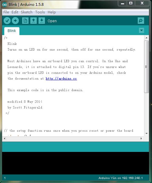

Detect IP from Arduino IDE
If the Ethernet port of Iduino_Yun_Shield is connected to Uplink Router or Wifi Router, the PC in the same network can use Arduino IDE to detect the IP of Iduino_Yun_Shield.

Make sure your laptop and Iduino_Yun_Shield are in the same network. The Iduino_Yun_Shield will broadcast data in this network and Arduino IDE will show Iduino_Yun_Shield in Tools>Port after receiving this data.
detect Iduino_Yun_Shield
Upload Sketch
1) In the Arduino IDE, choose correct board type for AVR module.
2) In the Arduino IDE, choose correct port (may be the address of Arduino Yun).
3) In the Iduino_Yun_Shield GUI>Sensor page, choose correct board type for uploading.
4) Compile and upload sketch to Arduino board. During uploading, the Iduino_Yun_Shield will ask you to input the password, which is “iduino” by default.
upload sketch

What if Arduino IDE doesn’t detect Iduino_Yun_Shield?
You can check the below issues:
1.Whether the Arduino version is 1.5.4 or later;
2.Whether you PC is in the same network with the Iduino_Yun_Shield;
3.If the Iduino_Yun_Shield boots in advance than Arduino IDE, this situation may happen. So try to reboot the Iduino_Yun_Shield and check again.
