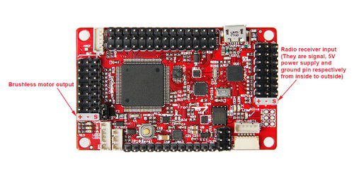

1)First, connect your receiver to the APM control board,(refer to the pictures below, 3-4,3-5,3-6).Then connect them to PC with a USB cable, (you can also connect through data transmission). Then, turn on the transmitting terminal of your remote controller, run MP, and you can select the COM port and Baud rate according to the following steps. Last, click connect --Install setup——Mandatory Hardware——Radio Calibrated.
[[File:RC STEP.jpg]]
[[File:RC STEP.jpg|500px|]]
[[File:APM RC 1.jpg]]
[[File:APM RC 1.jpg|500px|]]
[[File:APMRC2.jpg]]
[[File:APMRC2.jpg|500px|]]
[[File:RC3.jpg]]
[[File:RC3.jpg|500px|]]
