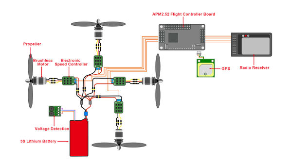

1)First, connect your receiver to the APM control board,(refer to the pictures below, 3-4,3-5,3-6).Then connect them to PC with a USB cable, (you can also connect through data transmission). Then, turn on the transmitting terminal of your remote controller, run MP, and you can select the COM port and Baud rate according to the following steps. Last, click connect --Install setup——Mandatory Hardware——Radio Calibrated. | |||
[[File:RC STEP.jpg]] | |||
[[File:APM RC 1.jpg]] | |||
[[File:APMRC2.jpg]] | |||
2)Click the calibration button, you will receive the following two prompt massages,( That is very important, you are advised to connect USB and receiver to the APM board only in this step) | |||
3)Click OK and move all RC sticks and switches to their extreme positions, so the red bars can hit the limits. | |||
4)When the red bar hits the limits, click Click when done to save the calibration. The RC calibration completes after two OK windows popped up. | |||

3. 8 channels of signal input
4. 8 channels output of steering-engine and electronic speed controller
5. Multiple interfaces:
--I2C,
--PM,
--Voltage transducer
--Current transducer
--GPS interface that supports MTK Protocol
--Air Radio data transmission and OSD image transmission
--ACM ultrasound waves and APM airspeedometer
6. pan-tilt output channel
