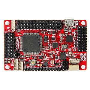

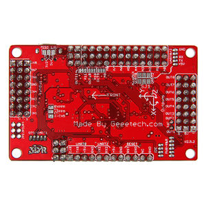

[[File:正面.jpg|600px|]]
[[File:10.jpg|300px|]] [[File:APM 2.52 FRONT.jpg|300px|]]
[[File:APM 2.52 FRONT.jpg|600px|]]
'''APM2.52 Hardware Configuration'''

Hardware Specification
  • ATMEGA2560 microcontroller
  • MPU6000 3-axis gyroscope and 3-axis accelerometer
  • MS5611 pressure sensor
  • HMC5883L 3-axis Magnetometer
NOTE:
Your APM 2.5 board is designed to be powered by the included Power Module via the Power Port connector. You can, however, power it from an ESC or some other external 5v source, although that can be less reliable. If you do choose to use an alternative power source, you need to put the little jumper that came in the bag on JP1 pins, next to the "new diode" marked at the left above. If you are not powering the board from an external source, the JP 1 jumper should be off (this is the normal configuration) If you want to explore other alternative power schemes, a guide is in the Appendix here.
