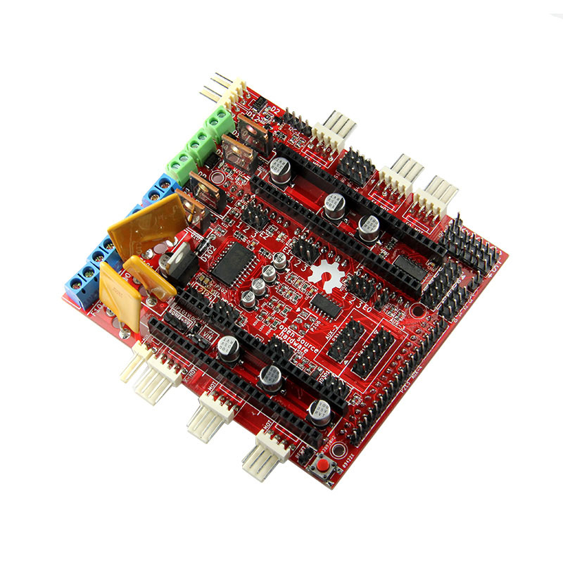

RAMPS For Arduino Due
Arduino Dueis the new Arduino board that is using an ARM Cortex M3 CPU.
The Atmel SAM3X8E chip used on the Due operates at 3.3V and is not compatible with 5V. Therefore the RAMPS shield will not work with Due, and worse applying 5V to the Due's inputs will likely damage the chip.

Why should i use Ramps-FD instead of Ramps1.4
Campare Ramps-FD with Ramps1.4,the Improvements of Ramps-FD are below
  • The RAMPS-FD has other hardware protection, through the jumper cap control motor drive IC
  • The RAMPS-FD Much more than Ramps1.4 2-way PWM
  • The RAMPS-FD has Larger driving power than Ramps1.4
  • The RAMPS-FD 'POWER has two choices:12v and 24v
