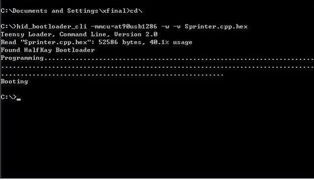

Programming the Firmware
AT90USB1286 on the Teensylu has been preinstalled the LUFA HID bootloader for that allows for programming the firmware using USB port or USBtiny ISP.
Windows
  • Remove the HWB jumper beside the chip.
  • Press the rest button to start the bootloader.
  • Windows will find the new hardware as the virtual com port. If windows find the unrecognized hardware, install the USB Serial driver
  • Install the WinAVR
  • Run the cmd.exe in windows, input the command line
 hid_bootloader_cli -mmcu=at90usb1286 -w -v Sprinter.cpp.hex
  • After flashing the firmware, replace the HWB jumper and push the reset button to run the firmware.
