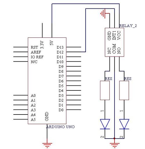

Pin definition
  • COM- Common pin
  • NC- Normally Closed, in which case NC is connected with COM when INT1 is set low and disconnected when INT1 is high;
  • NO- Normally Open, in which case NO is disconnected with COM1 when INT1 is set low and connected when INT1 is high.
Terminal 2 is similar to terminal 1,except that the control port is INT2
  • INT 1- Relay 1 control port
  • INT 2- Relay 2 control port
Usage
Example code
int Relay = 12;
void setup()
 pinMode(Relay, OUTPUT);     //Set Pin12 as output
void loop()
         digitalWrite(Relay, HIGH);   //Turn off relay
         delay(2000);
         digitalWrite(Relay, LOW);    //Turn on relay
         delay(2000);
