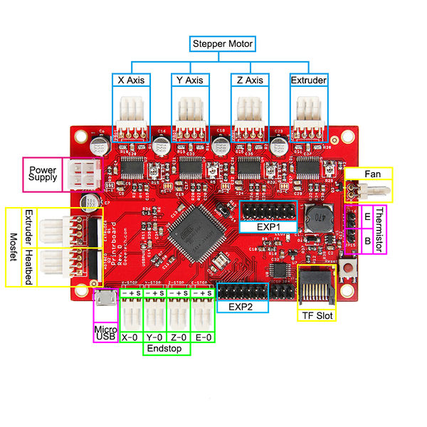

Interface
Interface Layout
Interface specifications

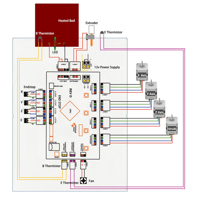

1. 2 channel ADC interface for thermometry: one for Extruder and another for Heatbed.
2. 3 channel PWM: one for extruder control, one for heatbed and one for fan.
3. 4 channel endstop: for x/y/z/e separately to connect to mechanical or optic endstop or hall sensor.
4. With TF card slot which supports 8G <= FAT16 and FAT32.

1. The LED doesn’t light when connected to USB and 5v external power supply.
① LED is broken ② LED is not well welded ③ the power supply doesn’t work.
2.How to solve it if the driver installation failed?
Click here to reinstall the driver.
3.What type of printer can Printrboard be applied to?
Solidoodle,printrbot,and most type of reprap(with a stepper motor driver for Z axis and single extruder)
4.How come the stepper drivers of X/Y/Z axis cannot run in normal direction?
①The endstops didn’t connect or it is a matter of poor connection.
②The IC of stepper driver broke down
