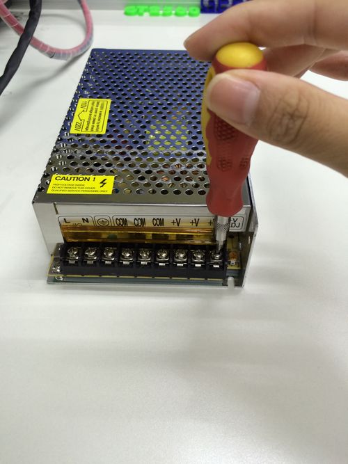

==connect power supply==
1.Take out the powersupply unit, check the condition of it and check it is 220V or 110V, you can switch it according to your real situation. this is very inportant.
2. Loose the screws on the connector,then screw the wires up in order, you can refer to the color of the wire, as shown in the following picture.
[[File:Power supply1.JPG|500px]]

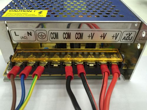

<font color=red>
L -- brown
N -- blue
GND -- yellow
COM -- black
+ V -- red
</font>
[[File:Power supply wiring.JPG|500px]]

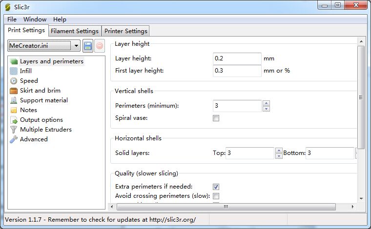

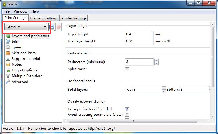

===slic3r setting test===

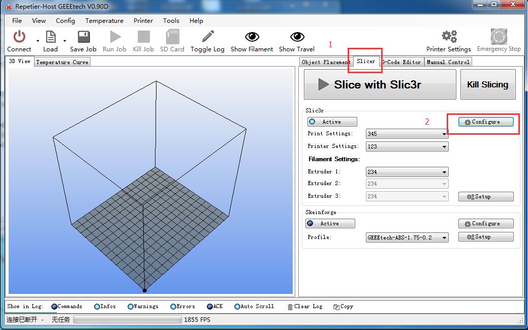

1. Open your Repetier Host and click ''slicer'' and ''configure''
[[File:Slicer setting1.jpg]]
2. you can see the slicer confirure pannel now.
[[File:Slicer setting2.jpg]]
3.Now you can load the ini file into the slicer or  configure the parameters one by one, firt let's see how to load the file.

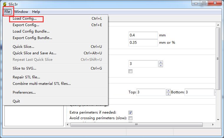

step 1. click ''file''> ''load Config''
[[File:Slicersetting load.jpg]]
4. Find the ini file in your computer. and you can see the parameters changed accordingly.
[[File:Slicer setting load 2.jpg]]
5. You can download the configure file here.[[Media:MeCreator.rar]]
L -- brown
N -- blue
GND -- yellow
COM -- black
+ V -- red

slic3r setting test
1. Open your Repetier Host and click slicer and configure
step 1. click file> load Config
5. You can download the configure file here.Media:MeCreator.rar

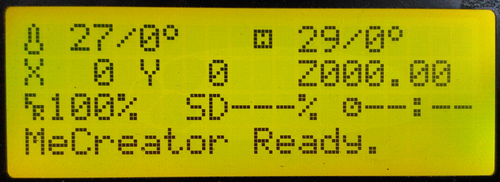

How to control on LCD
1.How to print from LCD
Note:
1)If you do not set the temperature of extruder and hot bed in g-code, you should manually heat up extruder and hotbed to proper temperature before printing.
2)If you do not set letting all the axes auto home in g-code, you should manually let all the axes auto home first.
Press the button>"Print from SD">Choose the file you want to print and press button.
2.How to let all the axes auto home
Press button on LCD> “Prepare”>“Auto home”
3.How to move the axis and extruder motor separately
Press the button>”Prepare”>”Move axis”>”Move 10mm/1mm/0.1mm”>”Move X/Y/Z/extruder”>Rotate the button>Press the button
Note: The extruder motor can not move unless the temperature is more than 180 degrees.
4.What if you can not move the axis with you hand
Press the button>“Prepare”>”Disable steppers”
5.How to set the temperature of extruder
Press the button>“Control”>”Temperature”>”Nozzle”>Rotate the button>Press the button
6.How to set the temperature of hot bed
“Control”>”Temperature”>”Bed”>Rotate the button
