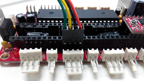

=Mount the control board on the left side panel=
<font color="red">'''Example 1: Sanguinololu'''
==<font color="red">'''Example 1: Sanguinololu'''==
Here we take the Sanguinololu as an example.<br>
Line 744: Line 753:
You need to plug 12 caps in all.<br>
[[File:Acrylic Prusa I3 (8mm)pic62.png|400px]]  [[File:Acrylic Prusa I3 (8mm)pic63.png|400px]]
Step2. Stack the 4 A4988 on Sanguinololu <br>
Step2. Stack the 4 A4988 on Sanguinololu (It is recommended wear static gloves when plugging A4988)<br>
[[File:Acrylic Prusa I3 (8mm)pic64.jpg|500px]]
Line 753: Line 764:

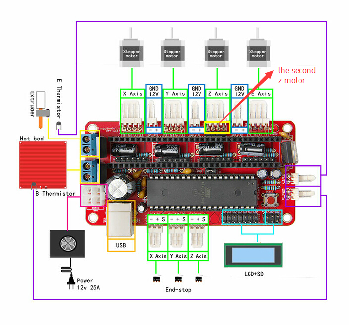

Step4, connect all the wires to the interfaces of the board
Step4. Connect all the wires to the interfaces of the board
The referring wiring schematic diagram of Sanguinololu
<font color="red">* use the Dopont cable in the package to strech the wire of fan for extruder, you just need to connect the black and red one, leave the yellow one alone.
<font color="red">* use the Dupont cable in the package to strech the wire of fan for extruder, you just need to connect the black and red one, leave the yellow one alone.
[[File:Prusal I3 manual pic86.png|500px]]
[[File:Sangui.jpg|800px]]
*Fan is connected to GND 12V, connect the red wire to "+", and black to "_". For the fan of extruder, you have to use the 2-pin DuPont wire to extend.

<font color="red">Note: when connect the other Y-motor, use the 4-pin M-F DuPont cable and pay attention to the directions of the wire. If you connect them reversely, the 2 Z motor will move in different directions.
<font color="red">Note: when connect the other Z-motor, use the 4-pin M-F DuPont cable and pay attention to the directions of the wire. If you connect them reversely, the 2 Z motor will move in different directions.
Look at the colors of the wire.<br>
[[File:QQ截图20150319145742.png|500px]]
[[File:Mount z motor dupont.png|500px]]
Step1, plug the jumper caps on the following pins of the board. (In the yellow circle)
* These caps are very tiny; do not throw them away inadvertently.
The jumper caps are packaged along with the board, do not lost them.
Step3. Stick the heat sink on the chip of the 4 A4988.
  • Fan is connected to GND 12V, connect the red wire to "+", and black to "_". For the fan of extruder, you have to use the 2-pin DuPont wire to extend.
also you can refer to the board cover.
For more information about Sanguinololu, please visit the wiki page.
